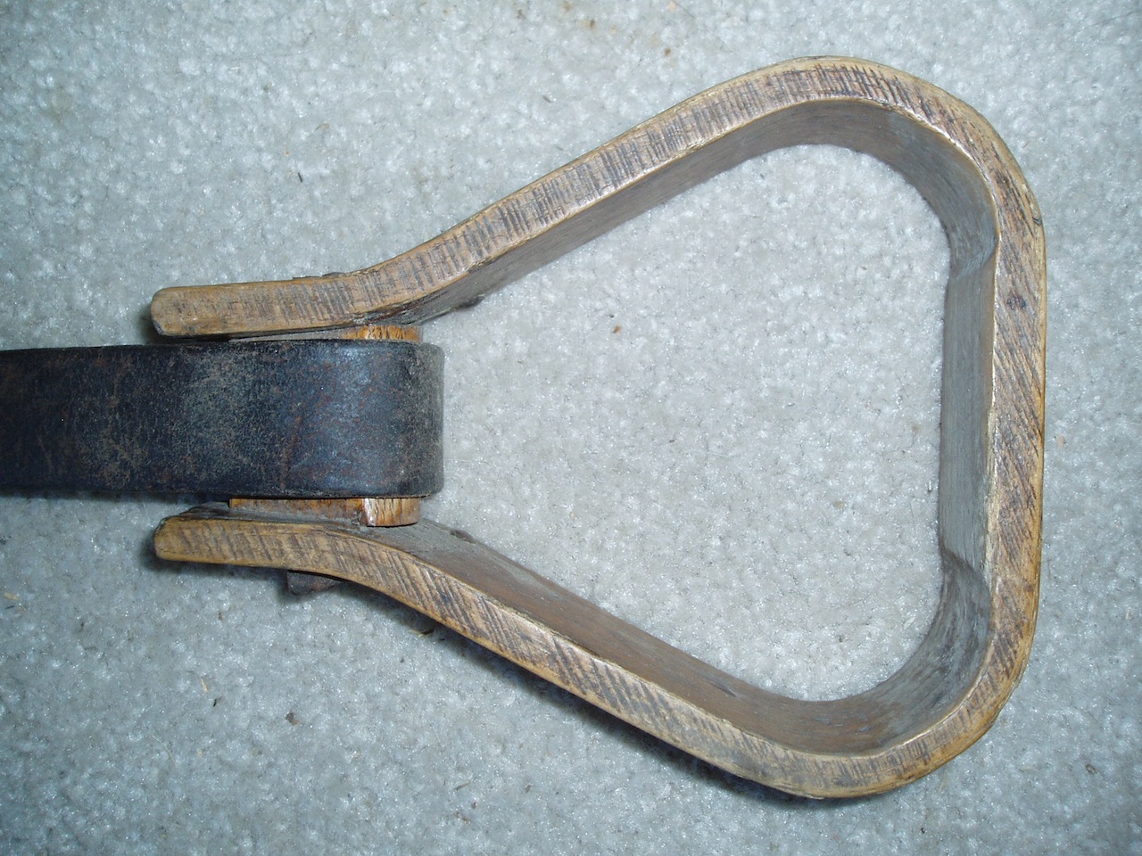

The 1912's were knife-edge stirrups, primarily for the artillery. I've heard said that they aren't very comfortable after long period of time, and tend to eat up boot soles. Cutting down wooden stirrups was an extremely low cost way to convert existing stirrups to a somewhat better form - it was all about the cost.6. The McClellan hooded stirrup is heavy, bulky and clumsy. The weight of the hood causes the tread of the stirrup to fall forward, so that the trooper cannot depress the heel as prescribed without lifting the whole weight of the hood. The width of the stirrup at the top causes acute discomfort to the ankle when the foot is thrust home. After more than twenty-seven years' service, mostly with troops, in colder climates and in hot climates, in fair weather and foul weather, the only possible virtue that I can attribute to it is its protection to feet stuck out too far in close order drill. As a matter of fact, such feet occupy the same relative position as heads thrust out of car windows; they need bumping.
Do we generally agree with Col Whiting?Todd wrote:Lt. Col. Whiting had the usual opinion of the hooded wooden stirrups (http://www.militaryhorse.org/studies/mc ... cation.php)BobH wrote:Outstanding!
Thanks, Todd, and to those who replied offline.
OK - any idea why, other than the general urge to change something, they went from the 1912 steel back to cut down wood in 1940? I don't recall the author but I remember reading a turn of the century diatribe against the hoods/tapaderos - very sarcastic and funny, but clearly on target.
I have a little experience with the hooded stirrups and didnt' think them that bad.

I did use steel stirrups on a Mac in the bush. They were great. When I got my new Mac 1904 from Tom Smith I had my problems getting used to the heavy wooden and hooded stirrups. After a few years now, I wouldn't exchange them for steel stirrups. Why? As mentioned in another thread they are much mor safe and comfortable when you wear heavy mountain or army boots. I don't use them for dressage or jumping, but what they were invented for, I still believe they suit the purpose very well. That is my personal opinion, having used both types of stirrups over the years. What I don't like about them is that they are quite bulky when you transport the saddle, but I have a bakkie (pick up) so space is not the issue. And they sure enough do protect your feet from rain and dew, as well as snow and the sun. So I'll stick with the "ancient" version, they suit me fine.

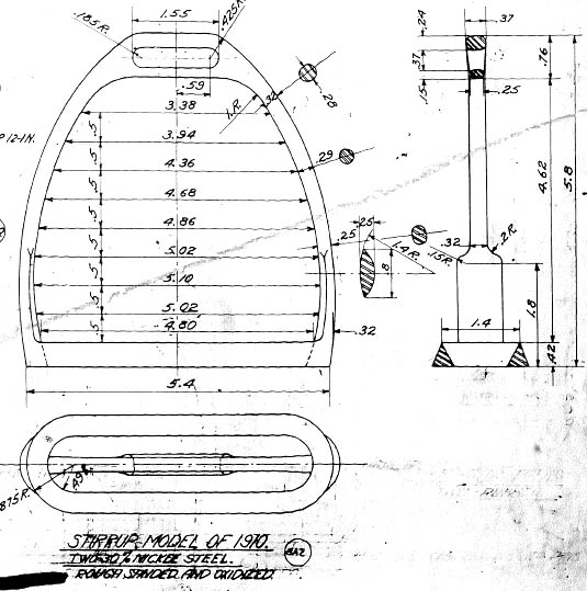

I once had a RIA-made knife-edge steel stirrup, nearly identical to the M1912 artillery/cavalry stirrup, marked with a 1911 mfg. date. The knife edge had a cross-section where the top edge was in the middle, rather than the 1912's top edge on the outer top. Come to find out that this is a M1910 stirrup, made for the Whitman-McClellan officer saddle.
- Model1910_stirrup.jpg (85.35 KiB) Viewed 35407 times
Once again - lots of expertise and sound evaluation.

And Tom, I hadn't thought about it like that but you make a superb point. I can't imagine field boots or combat boots in the steel stirrups. The wooden ones, with or without the hoods, make a lot of sense from a simply practical perspective.

Thanks Tom.Tom Muller wrote:I did use steel stirrups on a Mac in the bush. They were great. When I got my new Mac 1904 from Tom Smith I had my problems getting used to the heavy wooden and hooded stirrups. After a few years now, I wouldn't exchange them for steel stirrups. Why? As mentioned in another thread they are much mor safe and comfortable when you wear heavy mountain or army boots. I don't use them for dressage or jumping, but what they were invented for, I still believe they suit the purpose very well. That is my personal opinion, having used both types of stirrups over the years. What I don't like about them is that they are quite bulky when you transport the saddle, but I have a bakkie (pick up) so space is not the issue. And they sure enough do protect your feet from rain and dew, as well as snow and the sun. So I'll stick with the "ancient" version, they suit me fine.
As noted, I found the hooded stirrups pretty serviceable for field use and I don't think I'd be inclined to switch out for steel stirrups. I've sometimes wished I had a set of stirrups with tapaderos for my stock saddle.
On stirrups in general, however, I did recently have an experience that might cause me to make a bit of a switch. My stock saddle has a very heavy pair of quite wide wooden stirrups. These are not hooded, just very stout and wide. I've always liked them, but just recently I had occasion to switch horses, and saddles, with my brother in law. He also uses wooden stirrups, but narrower ones. They aren't extremely narrow, but they are not as wide as mine, about the same width as those on the 1928 McClellan. I was surprised by how much more comfortable they were in comparison to my usual stirrups.
