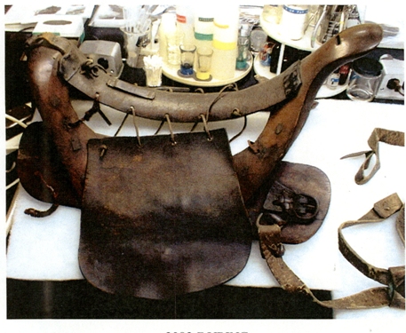

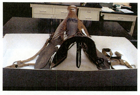

Need help identifying Possible 1805 UP saddle?
incunabule
img575 (2).jpg (155.62 KiB) Viewed 4708 times
Photo 1 of possble modified UP 1805
img574 (2).jpg (152.33 KiB) Viewed 4708 times
Need help and advice on identiying possble UP 1805 saddle in the collections of Jamestown/Yorktown Foundation, VA. Thank you Luther hanson QM Museum
Brian P.
Posts: 75
Joined: Thu Oct 05, 2006 3:28 pm
Last Name: Petruskie
Could this possibly be a Walker Contract saddle, or one of the of the other Hussar-type saddles used at the beginning of the 19th century? Does it have US military provenance?
DrsRob
Posts: 12
Joined: Sun Jun 17, 2012 1:13 pm
Last Name: Wolters
I don't think its a M1805 either.
You could check something though. From Dutch sources its clear that the M1805 has two-piece arches with dovetail connection. If your saddle has arches made from a single piece of wood, it's definitely not M1805.
