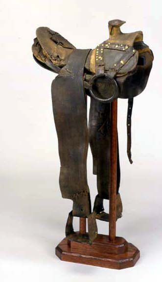

R.E. Lee saddle, near side. [4]

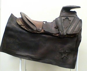

Saddle of Jefferson Davis, used while commanding the Mississippi Rifles regiment during Mexican War, and for some time afterwards.[4]
On January 10th, 1857, Chief of Ordnance Henry Knox Craig recommended to Secretary of War Jefferson Davis, to give “Mr. Childers” an order for 170 “Texas saddles” at $22.50 each for testing. [3] This purchase was quickly approved by Secty Davis the very same day, being quite familiar with the Texas-style saddle – as he had ridden one while commanding the Mississippi Rifles regiment during the Mexican War (seen to the left).  [4]

R.E. Lee saddle, off side. [4]
No existing examples of a Hopes trial saddle exist*, but it would probably be impossible to tell from any other made by Rice & Childress in this time period.  The Texas saddle used by Robert E. Lee, acquired while commanding the 2nd Cavalry in Texas at this time, is made with a typical ‘Hope’ tree, with a maker’s name mark on leather of “E. L. Hopkins.”.  From that example, we can see it is one of the Texas variants that has the sidebar protruding slightly forward of the front edge of the pommel.  The cantle is extremely low, and has a top edge with a near circular profile.
Note that the construction of Jefferson Davis’ saddle from the mid-1840s and the R.E. Lee specimen from a dozen years later are nearly identical, with exception of the horn ‘platter’ size.   This may be an illusion from the leather covering.

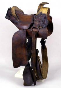

Joseph Johnston's Hope saddle
Joseph E. Johnston, while Lt. Col. of the 2nd Cavalry Regiment before the Civil War, acquired a Hope saddle attributed to Rice & Childress [4] (shown here).  It has been preserved and maintained at the American Civil War Museum in Richmond, Va.  Given that he was with the regiment in the vicinity of San Antonio when the lot of trial saddles was purchased from Rice & Childress, it’s reasonable to assume that this particular example has the closest form to the ones used in the trial, albeit with certain officer-grade embellishments.  He may have acquired this one prior to the trial saddle buy, as he wrote one of the letters of recommendation for it that were delivered to the War Department in early 1857.

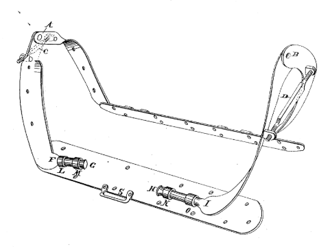

Patent drawing from Jones second patent – US Patent 11068
The saddest of the ‘also-rans’ in all this was an adjustable tree type invented by Lt. William E. ‘Grumble’ Jones of the US Mounted Rifles Regiment.  First tried in microscopic numbers in 1855 (approximately 26, distributed in the grand total of 2 per company [7] ),  it was approved for a large scale trial in the following year.  The few early reports were favorable (‘courteous’ might be a better description), if somewhat skeptical about durability.   The innovation of the design was a basic metal frame fitted on sidebars, with hinges at the tops of cantle and pommel, with the width adjusted by turnbuckle-type fittings, and swiveling sidebar attachment points. [8]  The design would have demanded that the pommel and cantle have a hinged, or split, top in order for the turnbuckle adjusters to function.
No real images of a complete saddle appear to exist, other than skeleton drawings from Jones’ patents.   Purest speculation, but the earliest 1855 pieces may have sported Grimsley-style hussar pommel and cantle pieces attached to the metal framework.  The later saddles purchased were a few years after the 1855 cavalry board design specification for an oval/semi-circular profile cantle, so it’s likely the later trial versions looked much like the Campbell and 1857 McClellan pattern – at least in their basic shape.
Excellent new insights on the Jones equipments recently discovered show that at least 300 were made by the well known firm of Lacey & Phillips, of Philadelphia, Pa., in early 1858.  Delivered in two lots of 150 each, in the months of January and February, with a per equipment set cost of approximately $39.00 each. [9]  That bit of information alone is suggestive as to why the Jones was not selected, barring any probable weaknesses with the patented gimmicks – it was nearly double the cost of its competitors.
